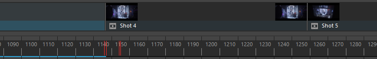

- Outside Range
Note: The black Outside Range status occurs only when animating in context, as it refers to the range of media shown in the Cut Slider.
- Black areas of the Cached Playback Status line indicate that the frames outside the current shot in the Cut Slider and are excluded from caching. Use the Discard frames outside current shot setting in the Cached Playback Preferences or Evaluation Toolkit's Caching section to turn off this behavior.
- You can click the
Focus icon
in the
Cut Slider controls to frame the animated shot without surrounding media.
Blue (needing rebuilding), and black (Outside Range) Cached Playback states

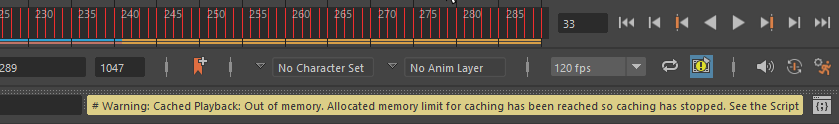

- Warning state
Cached Playback: warning state
- If the
Cached Playback encounters unsupported nodes or runs out of memory,
Cached Playback is disabled, and the status line and icon turn
yellow
to indicate that caching has stopped. You can continue working, but you won't have any performance gains from using
Cached Playback.
- Safe Mode
- This warning state triggers when Cached Playback encounters unsupported nodes so it is unable to send the animation to memory. Messages about what caused caching to stop are printed in the Script Editor.
- For information about the times when Cached Playback might be disabled, see Cached Playback limitations.
- Caching and Memory
- Caching will stop if your system does not have enough memory (RAM) to support the process. If a memory shortage occurs, a warning message appears in the
Help line. Change the amount of memory Maya assigns for
Cached Playback or if you want caching to continue despite memory limits in the
Cached Playback Preferences.
Cached Playback out of memory state
Note: You can continue to work even if Cached Playback stops. You just won't have any playback performance gains. - Customizing Cached Playback status
