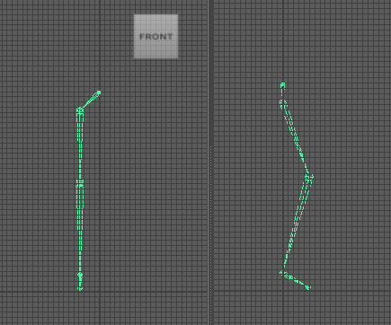

- In the Rigging menu set (press F3), select Skeleton > Create Joints.
- In a view, click where you want to start your joint chain.
- Click again in the model where you want to place the next joint in the joint chain.
A bone appears between the first and second joints.
In this example, joints are created using the Front and Side orthographic views
Tip: Middle-click and drag to move the last placed joint. - Continue clicking in the view until you create all the joints for your joint chain.
- Press Enter to complete your joint chain.

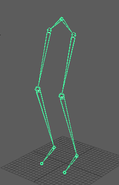

- Optional: Select the joints connected to the center joint, and duplicate them (Ctrl +
D) to create a second limb.
In this example, the joints are duplicated and dragged next to the first chain
The result in the Perspective view: a pair of legs
