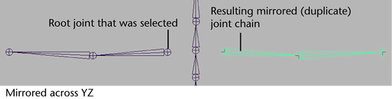

You can not create a mirrored duplicate of a joint chain using Edit > Duplicate with a Scale of -1. Use Skeleton > Mirror Joint instead.
To mirror a joint chain
- Select the parent joint of the joint chain you want to duplicate.
- In the Rigging menu set (press F3), select Skeleton > Mirror Joints >
. The Mirror Joint Options window appears.
- In the Mirror Across options, select the plane across which you want the joint chain mirrored.
These options represent the plane whose origin is at the joint chain’s parent joint.
- Set the Mirror Function.
- If you want to rename the mirrored (duplicate) joints, enter their old names in the Search For box and their new names in the Replace With box.
- Do one of the following:
- Click Mirror to duplicate and flip the current joint chain in the specified plane.
The Mirror Joint Options window closes.
- Click Apply to duplicate and flip the current joint chain in the specified plane.
The Mirror Joint Options window remains open.
- Click Close to disregard the options window’s settings.
The joint chain is mirrored across the selected plane whose origin is at the joint chain’s parent joint.
