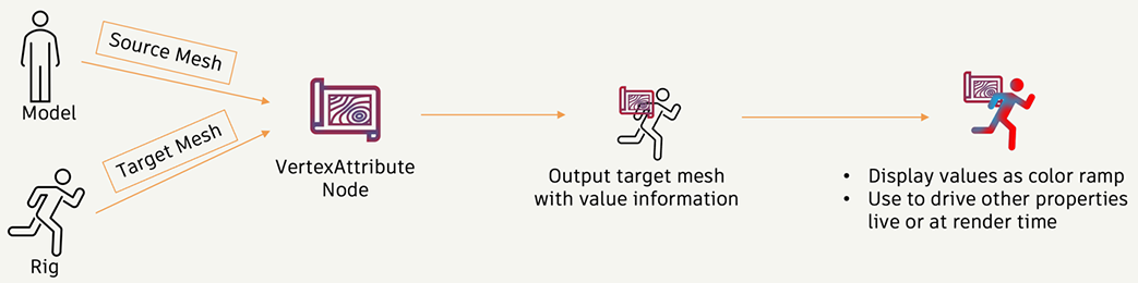

In this tutorial, you'll set up a tension visualization on a deforming mesh and learn the core workflow for using Dynamic Geometry Attributes in your rigging and character FX pipeline. By the end, you'll understand how to visualize stretch and squash data on your meshes.

The dgaTension node now compares your deformed mesh against the original, calculating surface tension based on the deformation.

  9. Scrub through your timeline. You should now see a heat map on your cylinder showing tension as it deforms.

  • Connect tension data to deformer weight lists to drive corrective blend shapes automatically.
