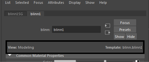

  4. When you select a view, its name and the name of its template display in the label line of the Attribute Editor.
    The template name is formatted differently for node type templates (<NodeType>) and node-specific templates (<NodeType>.<NodeName>).
    Tip: The label line can be hidden by turning off Show > Show View Labels.
