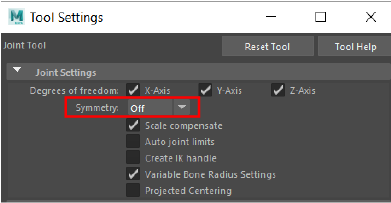

  1. In the Rigging menu set, select Skeleton > Joint Tool > .
    The Joint Tool settings appear.
  2. In the Joint Settings section, set the axis of symmetry by selecting X-axis, Y-axis, or Z-axis from the Symmetry drop-down list.
    Symmetry is Off by default.
    The Joint Symmetry drop-down list

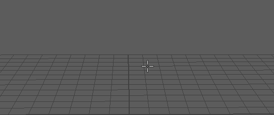

  1. Click the location in the model where you want to place your joint.
    Tip: Turn on Snap to Projected Center before creating a joint to automatically center it in your model.

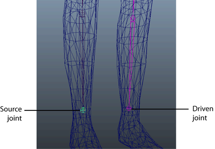

    The first joint, the source joint, is created. A second joint, the driven joint, is also created and is constrained to the source joint by a symmetry connection.
    Click to place a joint
    Note: In the current implementation, the Translate, Rotate, Scale, Rotation Order, and Joint Orient attributes are connected. All other joint attributes are not connected and stay independent.
    All driven joints and joint chains appear pink so they can be easily identified.

    Now when you modify the source joint, the driven joint updates symmetrically.
