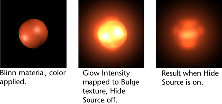

- Hide Source
Makes the surface invisible when rendered (if the Glow Intensity value is non-zero) showing only the glow effect. Hide Source is off by default.
- Glow Intensity
The brightness of the surface glow effect. The slider range is 0 to 1, but you can type in higher values to create a ‘blown out’ or ‘burn in’ effect. The default value is 0. Mapping a texture to the Glow Intensity can create very interesting effects. Turn on Hide Source to view the results.

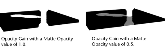

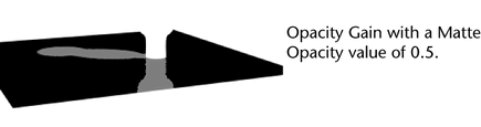

- Opacity Gain
This is the default Matte Opacity Mode. This mode produces both reflections and shadows.
The matte channel is first calculated, and then multiplied by the specified Matte Opacity value. The Opacity Gain value is used as a multiplier on the matte value produced by this material.
The Matte Opacity Mode value is also keyable. The Opacity Gain range is from completely invisible to no effect (rendered as usual).

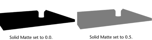

- Solid Matte
Solid Matte makes the value of the matte channel constant for the material. The value you specify in the Matte Opacity slider is used, instead of the default value.
Use Solid Matte to adjust the overall density or visibility of the Use Background material.

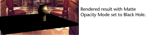

- Black Hole
When you select the Black Hole mode, the matte channel for the material is set to 0 (fully transparent). This creates a black hole in the alpha output where the object assigned shader renders the matte ‘knocked out’.
In this mode, the Matte Opacity slider is disabled and its value ignored.
Note:For the Opacity Gain and Solid Matte modes, if an object has non-zero Transparency, objects behind it make their usual contribution to the matte channel’s values. This is the difference between setting Matte Opacity to 0.0 in these modes, and choosing the Black Hole mode.

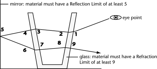

- Refraction Limit
The maximum number of times the surface allows a light ray to be refracted. For example, if the Refraction Limit value is 10, the surface refracts light rays that have previously been refracted and, or reflected (off itself or off other surfaces) 9 times or less; the surface does not refract light rays that have previously been refracted and, or reflected 10 or more times. The valid range is 0 to infinity. The slider range is 0 to 10. The default value is 6. Increasing this value may significantly increase render times.
You must also consider the Render Settings window Raytracing refractions attribute too. Maya uses the lower value of the 2. For instance, if your limit is set to 9 on the material and 6 in the Render Settings window, a value of 6 is be used. See also Reflection Limit
In the following example, a glass sits in front of a mirror.
The number of refractions includes both the entry and exit of a light ray from a surface having thickness.
The physical property Total Internal Reflection (TIR) can make some transparent objects appear not to refract light. This is caused by light rays reflecting inside the thickness of the object. If this occurs, increasing Refraction Limit has no effect because the Reflection Limit is stopping light rays before they can exit the surface. However, because TIR is a real-world property, you may want to keep this effect.
Tip:To simulate realistic looking glass, set the Refraction Limit value to 9 or 10.
