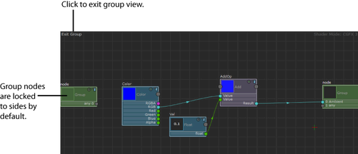

  1. Click the Group icon on top of the node to visualize its group network.
    To return to your main node network, click Exit Group in the upper-left corner of the ShaderFX editor.
Note: By default, the group nodes are locked to the sides of the ShaderFX editor. To customize their location and move the nodes, disable Settings > Lock Group to Sides.
