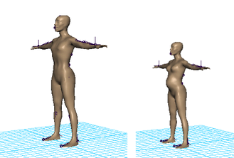

For example, if you export the smooth skin weight maps from the character on the left to the smaller, pregnant character on the right, the skin deforms the same on both. This saves you time painting weights on the pregnant character.
