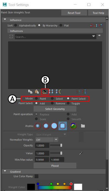

Paint Weights Tool: A. Modes B. Weight Hammer
- In the
Mode options, choose
Paint,
Select or
Paint Select (see
A. in the image above).
Tip:
Use the hotkeys Ctrl + < and Ctrl + > to quickly toggle between these modes.
- Select the vertices you want to fix.
- Select
Hammer Skin Weights
from the icons below the hePaint Skin Weights Tool Influences List (see
B. in the image above) or from the
Skin menu.
Hammer Skin Weights assigns the selected vertices the same weight values as their neighboring vertices. When you exercise the skeleton, you see smoother deformation results.
