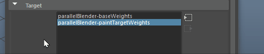

Target
Target List
Lists the target shapes for the selected base shape. When painting blend shape weights, you can only select one target shape from this list at a time. If you delete any of your target shapes from your scene, they remain listed and available for selection in this section.
Click the Node Navigator buttons to select an input or output parallel blender node.
Choose an Input/Output parallel blender node
