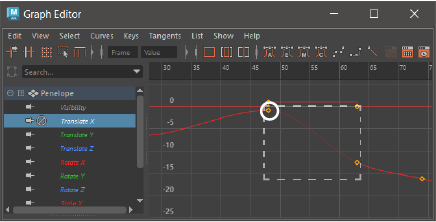

    • In the Graph Editor Mute appears under the current animation channel’s name in the Outliner and a Mute curve with keys appears in the view area.
      Graph Editor: Muted Key (circled) and the ignored region of curve/channel (dotted square)
      The Mute curve has the same number of keys and they are positioned the same as those on its animation channel.

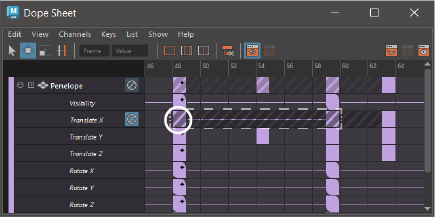

    • In the Dope Sheet, the muted key appears striped out.
      Dope Sheet Editor: Muted Key (circled) and the ignored region of curve/channel (dotted square)
