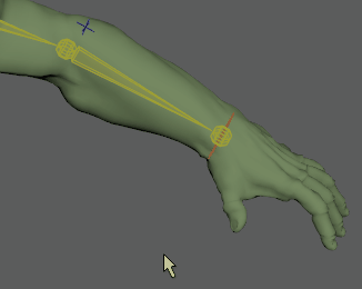

While animation curves and key information exist for an IK handle, there is no information available for an IK joint because its position is determined by the animation on the IK handle. To view and edit the animation information of an IK joint, perform a bake animation.

To create keys for an IK joint by baking
- Select the IK joint.
- Select
In the Bake Simulation Options window, set the Sample By value.
- Verify that the Disable Implicit Controls option is turned on to retain the animation imparted by the first joint in the IK chain.
- Click the
Bake button.
Note: If the simulation is slow, change the settings in the Performance Settings area of the Bake Simulation Options.Maya steps through the animation. It evaluates the scene for each time interval specified in the Sample By field and places a key at each time. The new keys appear on the Time Slider.

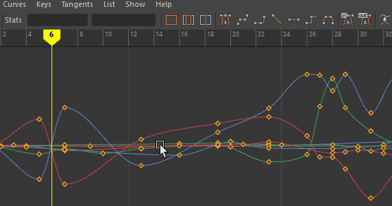

Bake animation in the Graph Editor
You can bake animation in the Graph Editor if you want to edit a single animation curve instead of all the contributing attributes that affect the behavior of a single attribute, for example, an object affected by a driven key or an Expression.
When you bake keys on an animation channel, a key is set every frame on the curve.
In the Graph Editor
Ensure that all the animation you want to bake is showing in the Graph View and select Curves > Bake Channel from the Graph Editor Curves menu.
