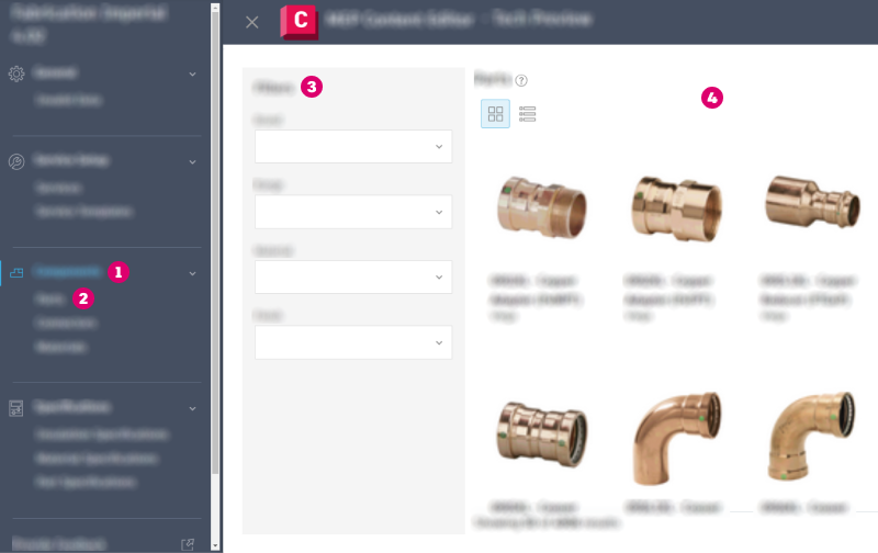

Click the or the icon to change the display of the parts.
When you click Parts (2) in the left side pane, under Components (1), you'll see a list of all parts (4) in the current fabrication configuration.
To locate a group of parts, select one or more Filters (3) on the left to display a list of parts based on Brand, Range, or Material.
Note: Brand and Range data is inherited from the Product Info database, so may not be available for all parts in the current fabrication configuration. Use the Product Information Editor to add Brand and Range data to an MEP fabrication configuration. See Additional Software.
To locate a part when you know part of or its entire name, in the Search field, enter text from the part name.
The more information you provide, the more you narrow the search.
