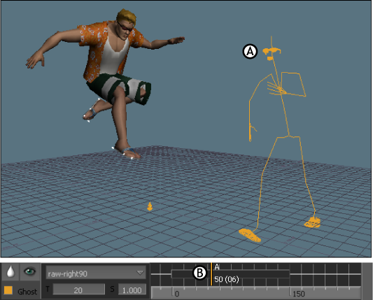

Show column
Activate the corresponding option in the Show column to show or hide each Pose Ghost in the Viewer window. This way, you can visualize the position of the character so you can better position it.
Ragdoll Pose Ghosts A, B, and C
A Match pose is red and a Guide pose is green.
See Match and Guide poses for more information.
