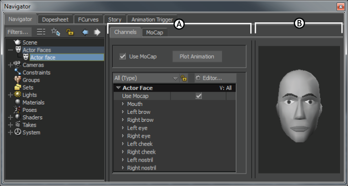

Actor Face settings
The Actor Face lets you do the following:
- Connect motion capture data from a live or recorded source to an Actor Face.
- Plot motion capture data from a live or recorded source to an Actor Face.
- Animate expressions plotted to an Actor Face using keyframe animation and constraints.
- Use as a motion source for a Character Face to animate the shapes of a head model with live or recorded motion capture data.
The Actor Face settings consist of the following areas:
Actor Face settings A. Channels pane B. Preview pane
