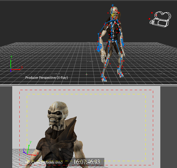

For example, if you have a scene with motion capture data that shows a Character driven by motion capture markers and a skeleton and marker data driving a constrained camera (as shown in the top Viewer pane in the following figure), you can record the motion capture data, however, what you really want to record is the end result—the data recorded to the camera and the data recorded to the retargeted character. In the following figure, the bottom Viewer pane displays what you see through a Director's camera.

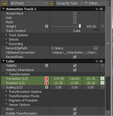

  3. (Optional) To verify the Track's recording path, in the Property Resources window, expand the Track and expand its Recording properties to view its contents.
    The RecordClipPath field displays the Track's recording path.
    Note:
    You can set Record via the Property Resources by enabling RecordToTrack Recording property.

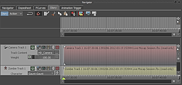

    Story tracks representing the recorded data
    The Tracks display the token naming convention you defined.

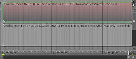

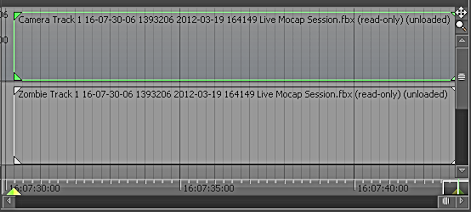

    The Tracks in the Story window are now gray, meaning they are just a representation of the tracks recorded to disk. The Tracks are in fact unloaded.
    If you prefer to have the recorded Tracks loaded as opposed to unloaded after the recording, you need to change the Story recording preferences.

  • In the Story window, right-click the Story Track you want to reload and from the context menu, select Load/Unload > Load Clips.
    The following figure shows one Story Track was selected to be reloaded.
    The recorded Story Track is loaded into the Story window, enabling you to edit the track. The Story Track is no longer gray, meaning it is loaded.
