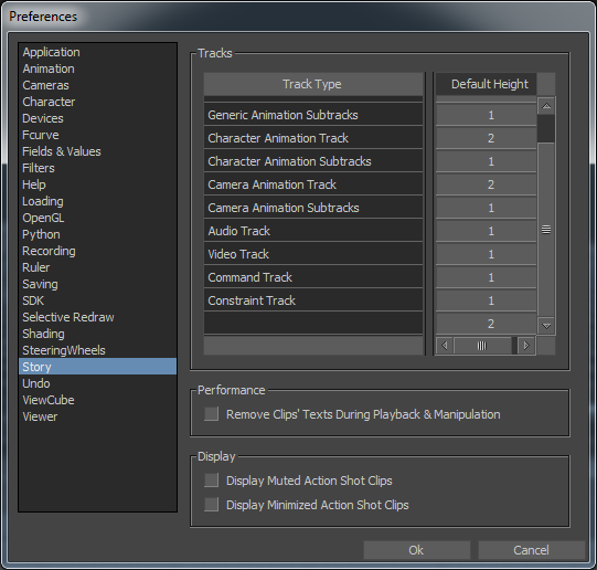

Before you start recording, make sure the Story recording, clips, and Track preference settings are set to your needs.
To access the Story preference settings:
  1. In the menu bar, select Settings > Preferences.
  2. In the Preferences window, click the Story preference option.
    The Story preference settings display.
    Story preferences
