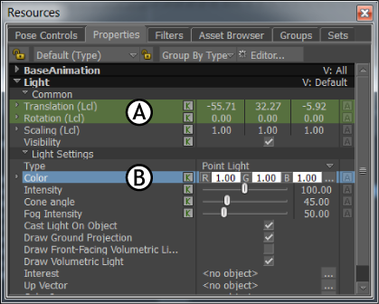

Static keying groups display the properties that they keyframe in light blue. Those properties receive a keyframe when you click the Key button or press the K keyboard shortcut, but they are not selected.
Selected properties display in dark blue. Selected properties are also keyframed when you click Key.
Context Keying Modes A. Light-blue properties receive keyframes B. Color property is selected and can also receive keyframes

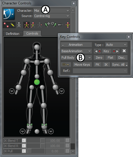

Keying modes in the Character Controls
When working with Control rigs, keyframing is relative to the selected keying mode in the Character Controls.
A. Full Body is the Keying group in the Character Controls window B. Full Body displays in the Key Controls window
Depending on the selection, setting a keyframe applies to either the full body (Full Body mode), the selected body part (Body Parts mode), or the selected effector (Selection mode).

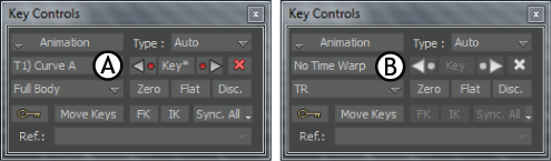

TimeWarp Curves
When the TimeWarp pane is active in the FCurves window, TimeWarp is the active Keying group, and the keying options are contextual to the selected object’s TimeWarp curve.
Key Controls window A. TimeWarp curve name B. TimeWarp is active, but there is no TimeWarp curve
If the TimeWarp pane is active but there is no TimeWarp curve, No Time Warp displays in the Key Controls window, and the Keyframe buttons are not available.
