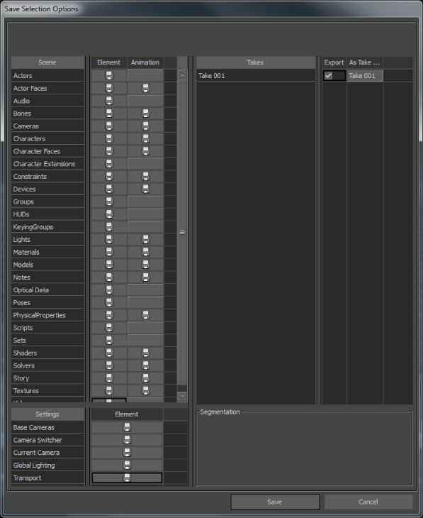

    The Save Selection Options dialog box appears.
  4. In the Save Selection Options dialog box, disable the takes in the Export column, then click Save.
    Only your Marker set and Actor settings data are saved in an .fbx file.
