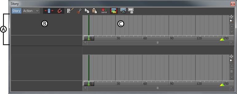

The Edit Track list consists of the controls for the tracks it contains and the Edit timeline. See:
Story window A. Edit Track list B. Edit Track controls C. Edit timeline

Edit timeline
The Edit timeline displays the shot, audio, or video clips that you create and manipulate. You can add, schedule, and blend these clips along the Edit timeline.
To navigate the Edit timeline, Ctrl-drag to zoom and Shift-drag to scroll. You can also click in the Edit timeline and press A to frame all clips. See Story window time range for information on changing the time range.
