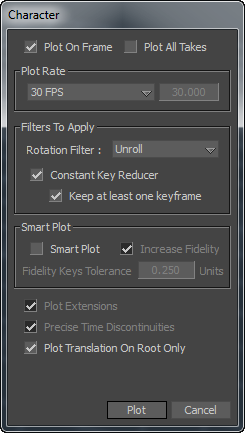

When you click from the:
  • Bake (plot) Skeleton or Bake (plot) Body Part option, the Plot Selected Properties dialog box appears. See Plot All Properties window.
  • Bake (plot) To Skeleton or Bake (plot) To Control Rig option, the Character dialog box appears.
