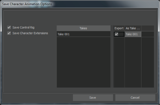

Save Character Animation
Lets you save the animation in the current character. You can choose to save the Control rig with one or multiple takes.
When you select this option, the Save File window appears. Specify the .fbx file name and saving location. When you click Save, the Save Character Animation Options dialog appears.
This dialog contains the following options:
- Save Control Rig — Lets you save the Control rig with the animation. Disable this option if you only want to save the character animation.
- Save Character Extensions — Lets you save any Character Extension with the animation. Disable this option if you want to save Character Extensions without the animation.
- Takes — Contains the following options:
- Take name — Shows the name of the take as it was saved in the .fbx file. You cannot rename takes using this column.
- Export — Marks the take for saving. When active, the corresponding take is saved to the .fbx file.
- As Take — Renames the take as it is saved to the .fbx file. If the Save One Take Per File option is active, the name of the take in the As Take column is used over the take name in the scene.
