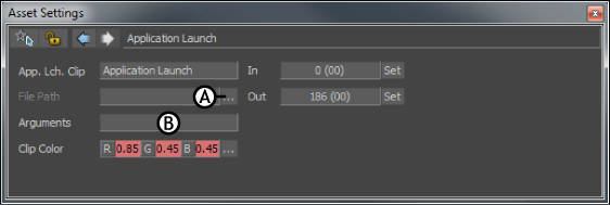

To create an Application Launch command clip:
  1. Double-click the Application Launch clip to select it.
    The clip’s settings display in the Asset Settings window.
  2. Click the browse button of the File Path setting, select the application you want to launch.
    Asset Settings window A. Browse button of the File Path settings. B. Arguments field.
  3. Type arguments in the Arguments field, if necessary.
    For example, to open Internet Explorer you can type the following path in the File Path field:
      C:\Program Files\Internet Explorer\IEXPLORE.EXE
    When the Application Launch clip plays, the Web browser opens.
    Add arguments by typing in the Arguments field. For example, to open the Autodesk Web site when an Application Launch command clip opens Internet Explorer, enter the following in the Arguments field:
      www.Autodesk.com
    When the Application Launch clip plays, Internet Explorer opens to the Autodesk web site.
    The arguments you type in the Arguments field depend on the application you launch.
