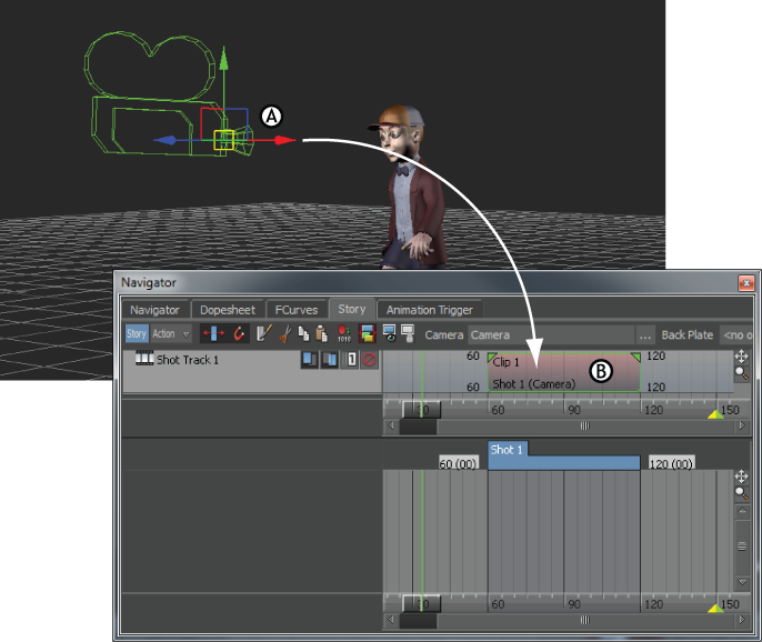

    A Shot track appears, and a shot clip is created for each camera you drag onto the Edit track.
    Shot clip A. Custom camera in the Viewer window B. Shot clip created after dropping the Custom camera into a Shot track

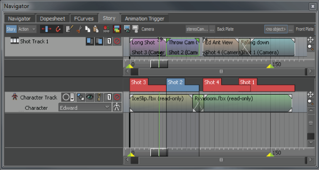

      Three cameras arranged into four shot clips on the Edit track
      In the preceding figure, the first and third camera shots are the same, only the shot clips are renamed.
