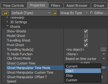

You can display the Story ghost clip manipulator at any frame in the timeline by setting a Ghost Manipulator Time Mode. By default, is set to Start mode, which displays the manipulator at the first frame of the clip.
To set a clip's Ghost Manipulator Time Mode:
  1. In the Story window, select the clip.
  2. In the Properties pane of the Resources window, expand Ghosts.
  3. Select Ghost Manipulator Time Mode and choose one the following options:
    • Current — displays the manipulator at the current frame of the clip.
    • Start — displays the manipulator at the start frame of the clip. This is default setting.
    • Stop — displays the manipulator at the last frame of the clip.
    • Custom — displays the manipulator at a specified frame.
  4. (For Custom only) Select Ghost Manipulator Custom Time and type the frame number you want the clip's ghost manipulator to display.
