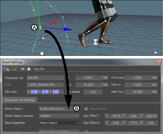

To select a match object:
  1. Double-click an animation, character, or camera animation clip in the Story window to access the Match Object field in the Asset Settings window.
    The match object you select affects how clips match. By default, a clip has no match object and the travelling node is used to match clips.
  2. Alt-drag an object into the Match Object field . You should only select a match object from part of the track contents.
    Selecting a match object A. Drag a selected node into the Match Object field B. The name of the custom match object displays in the Match Object field
The content of the Match Object field is affected by the options selected in Match Object Options menu and in the Blend Algorithm menu. See the Ghost Match Object section in Ghost Match Object and Blend Algorithm menu for more information.
