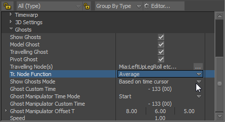

Assign travelling nodes to a Story clip:
  1. In the Story window, select the clip.
  2. In the Properties pane, expand Ghosts.

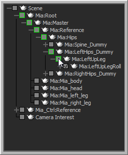

  3. Select Travelling Node(s), then click this icon, , to browse to the node(s) you want to assign to the clip.
  4. In the window that opens, expand the hierarchy and then select the nodes you want to use, such as a dummy node.
    The selected travelling nodes are now assigned to Story clip and display by way of the manipulator in the Viewer.
Set the location of the travelling node's manipulator display:
  1. In the Properties pane, select Tr. Node Function.
  2. Select one of the following options:
    • Average to position the ghost manipulator at an averaged distance within the selected traveling node hierarchy.
    • Project on XY Plane to position the ghost manipulator along the X and Y axis of the Viewer window grid.
