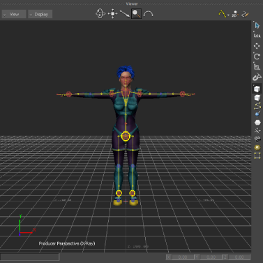

    See Creating a Control rig.
  2. Make sure they are in the default T-Stance position.
    See Stance.
  3. Press Ctrl-A until you are in X-Ray mode.
  4. From the Asset browser Solvers folder, drag a Physics solver into the Viewer window.
  5. From the Asset browser Physical Properties folder, drag the Ragdoll asset onto any part of a Control rig. This connects the ragdoll data to the Character solver.

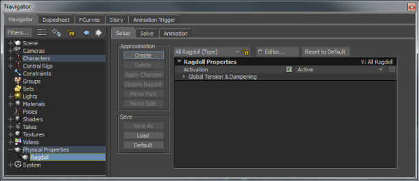

  6. In the Navigator window Scene browser, expand the Physical Properties folder and double-click the Ragdoll Physical property.

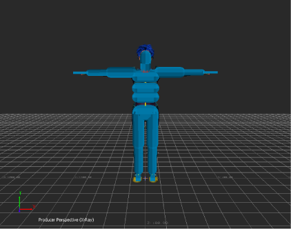

  7. In the Ragdoll Setup pane Approximation area, click Create. A proxy body is created on top of the Control rig.
    See Creating a Ragdoll Approximation
    Note:
    To hide the proxy, switch to Models Only mode (Ctrl-A).
  8. Expand the Physical Properties and define specific properties for the object, as well as in the Solve, and Animation panes.
    You can modify settings for individual body parts in the Properties area.

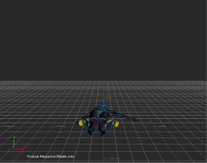

  12. Click Reset to Start to set the Control rig in the pre-collapse position.
  13. Press Record in the Transport controls.
    A dialog box appears asking if you want to overwrite the take or create a take.
  14. Select an option.
  15. Press Play in the Transport controls and Stop when the animation is over.
    The character collapses.
