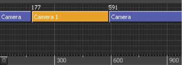

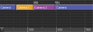

Switcher timeline before the Camera 2 switch is deleted
Switcher timeline after Camera 2 switch is deleted. Camera 1 fills the empty space.

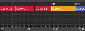

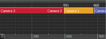

For example, in the following figure, there are three Camera 3 switches. In the figure that follows that, the Clean up button is clicked, and the three switches become one Camera 3 switch that lasts the duration of the previous three.
Three Camera 3 switches in a row
After clicking Clean up, the three Camera 3 switches become one

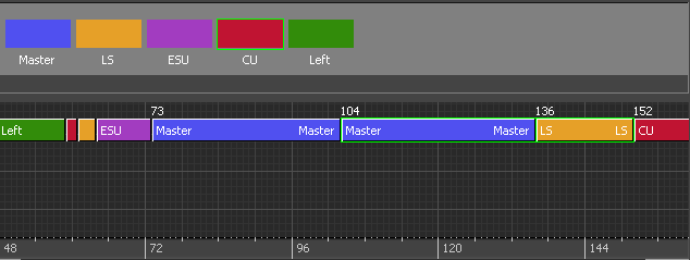

You can move a switch by dragging it to a new position on the Switcher timeline. You can also move multiple switches at once. Ctrl-click the switches you want to move, right-click the Switcher timeline. and then select Link selected clips.
Two camera switches linked
Two camera switches moved to the right

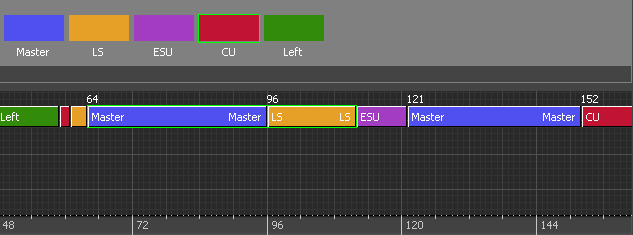

Swapping cameras
You can change the order in which the cameras are used by selecting a camera in the Switcher timeline, then clicking a different camera in the Camera Color row.
The selected camera in the Switcher timeline becomes the new camera for that camera switch. This does not alter the location of camera switches.

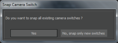

When you select either of the two snapping methods, a dialog box appears asking if you want to apply snapping to all switches or new switches .
Snap Camera Switch dialog box
Click “Yes” to snap all current camera switches or click “No, snap only new switches” to ignore the existing camera switches, and snap only new camera switches.
