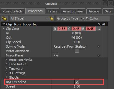

To lock a clip:
Select a clip in the Story window.
In the Properties tab of the Resources window, turn on In/Out Locked.

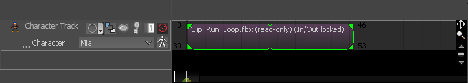

The title of the clip in the Story window updates to show it is locked:

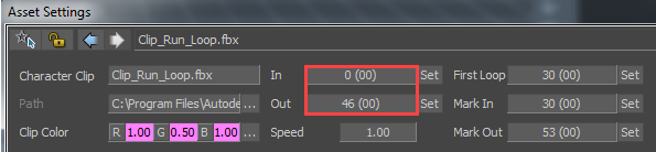

The In and Out parameters of the clip are locked and can not be modified:
