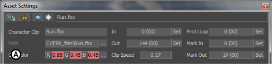

Double-click a clip on a track in the Story window. The Asset settings appear.
Change the values in the R, G, and B, fields of the Clip Color field, or click the Color Window (
) button to open the Color window.
Asset Settings window A. Clip Color settings
