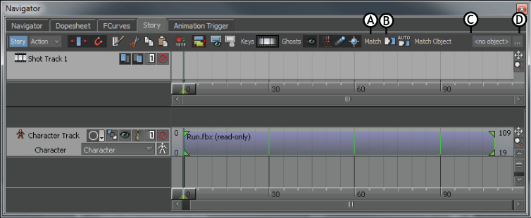

Match Controls in the Story window A. Match Options button B. Auto Match option C. Match Object field D. Match Object button

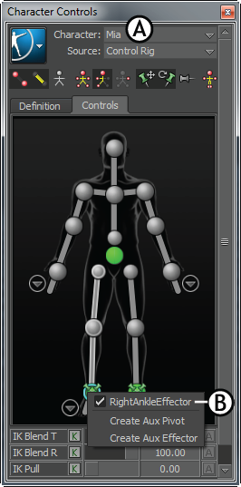

In the Character Controls, select the character from the Character menu, and right-click a character effector to select it to be the Matching object, for example, the character’s right foot.
Character Controls window A. Select your Character in the Character drop-down list B. Right-click an effector to select it

Click the Match Options button in the Story controls.
Story controls A. Match Options button
The Match Options dialog box displays with the name of the selected node appearing in the Match Object menu.
