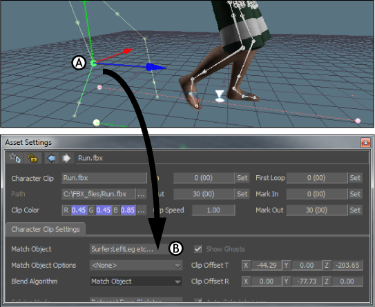

To select a match object, Alt-drag an object into the Match Object field. You should only select a match object from part of the track contents.
The content of the Match Object field is affected by the options selected in Match Object Options menu and in the Blend Algorithm menu. See Match Object Options field and Blend Algorithm menu for more information.
Selecting a match object A. Drag a selected node into the Match Object field B. The name of the custom match object displays in the Match Object field

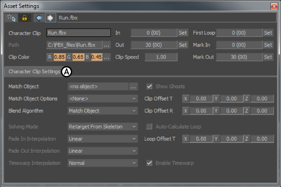

The Solving Mode menu, which displays for selected character clips, displays the current solving mode.
Character clip settings A. Solving Mode menu

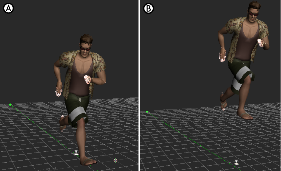

The loop offset is calculated automatically by default. Changing a loop’s translation offset causes the animation to jump at the beginning of each loop. For example, when you loop a basic run cycle, a Character runs forward in a straight line. If you change the loop’s translation offset, the Character jumps at the beginning of each loop.
Creating loop offsets A. The loop offset is calculated automatically, Surfer runs in a straight line. B. The loop is offset along the Y and X axes, causing Surfer to jump at the beginning of each loop
