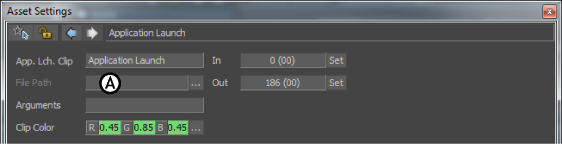

File Pat
The File Path field displays in the Asset Settings window when an Application Launch command clip is selected. The File Path field lets you choose the application you want to launch when the command clip plays.
You can type the path in the field, or you can click the browse
button beside the field to locate the file.
You can create Application Launch command clips by dragging an Application Launch asset from the Command folder in the Asset browser to a Command track in the Story window.
Common clip settings A. File Path field

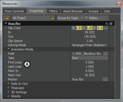

Last Loop
The Last Loop field in the Properties window lets you trim the end of the clip and determine at which part of the clip the last loop ends. The value uses the local time of the clip. For example, if you have a clip that loops three times, you can set the end of the third loop so that it is shorter than the previous loop.
Properties window A. Last Loop field
