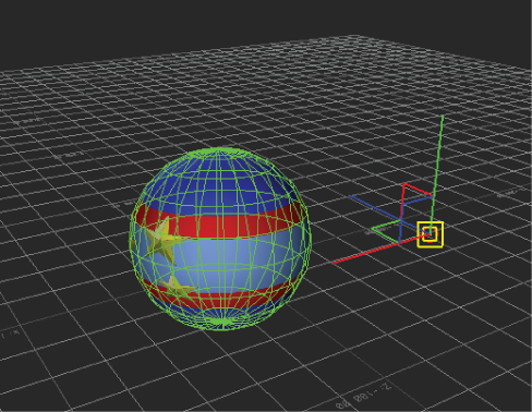

  7. In the Viewer window, either drag the pivot to reposition it or enter the desired XYZ coordinates in the Global/Local/Layer fields at the bottom right of the Viewer window.
    Pivot is offset
