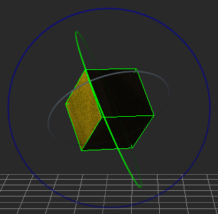

To display a locked Rotation property or channel in the Viewer window:
In the Navigator window Scene browser or in the Viewer window, select an object or element.
In the Viewer window toolbar select the Rotate tool (
) or the Rotate Around tool (
), or use the Rotate keyboard shortcut R in the Viewer window.
Gray X, Y, Z Rotation handles indicate a locked Rotation property, whether you are in the Global Reference mode (
), the Local Reference mode (
), or the Additive Reference mode.
Locked Rotation property displays gray X, Y, Z Rotation handles
In Global Reference mode (
), colored dash X, Y, Z Rotation handles indicate one or two of the Rotation channels are locked.
In Local Reference mode (
), a gray Rotation handle indicates a locked Rotation channel and colored dash Rotation handles indicate channels are not locked. The following figure shows the X Rotation channel is locked.
In Additive Reference mode (
), a gray Rotation handle indicates a locked Rotation channel and colored Rotation handles indicate channels that are not locked. The following figure shows the X Rotation channel is locked.
