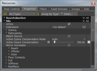

For example, the following figure shows the properties for a selected character, which also appear in the Character settings.
A character’s properties display.
