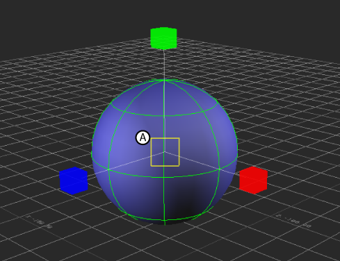

A yellow square appears at the center of the Transformation planes when you are in the Selection or XYZ Selection mode. This is the Free Transform plane.

Click in the Viewer window and press T, S, or R on the keyboard to activate translation, scaling, or rotation mode for the object. The yellow Free Transform plane (or ring) appears.
Sphere in Scaling mode A. Free Transform plane
If translating or scaling, hover your mouse over the Transform plane; the transform plane highlights as the mouse passes over.
