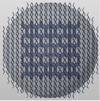

A simulation is a three-dimensional preview of your structure, constructed with help of your cells. It displays bars, faces, and STL elements of the multiplied cells, but does not take into account any bar profiles or face specifications. Solid areas are not displayed. The part is displayed in a transparent way, enabling a view on both its exterior shape and its interior structure.
