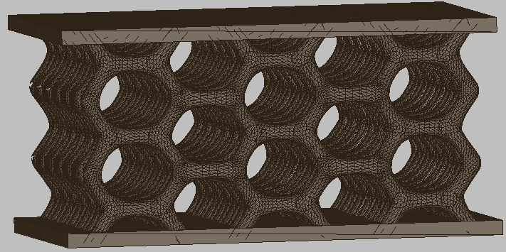

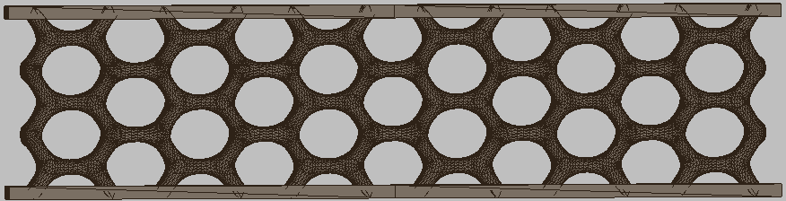

In the steps below, the default view is adjusted and the refinement level of the lattice mesh is increased.
- At the bottom left pane, switch to the Parts tab.
- Expand the Part node of the properties panel.
- Change the View to Shaded Wireframe.
- Expand the Lattice node of the properties panel.
- In the Modifications node, set Smooth to Fine.
- From the toolbar menu, click
Create Component
