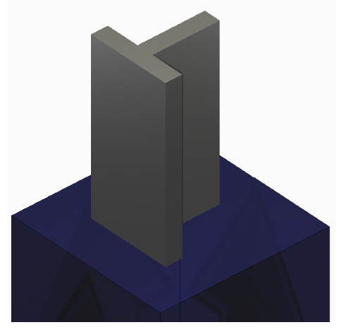

Figure 1: DED compensation example geometry

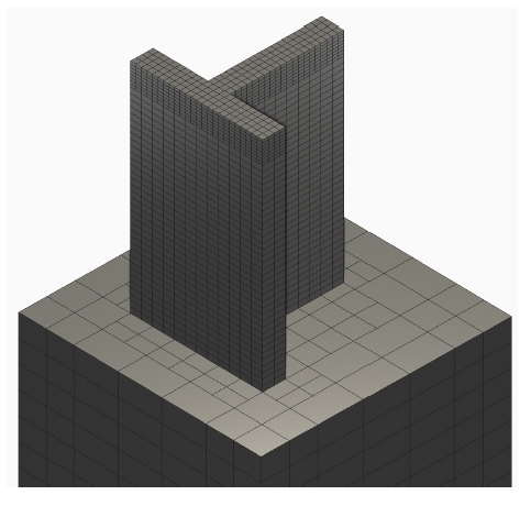

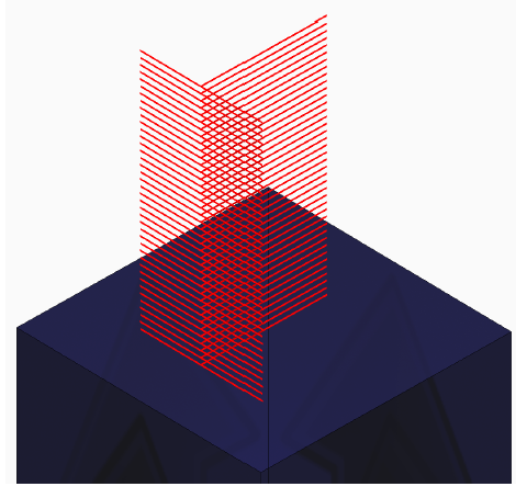

Figure 2: DED compensation example path
Figure 3: DED compensation example mesh
