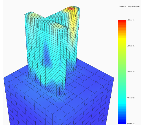

The results can be viewed in Simulation Utility for Netfabb or ParaView by importing the .case files. The post-process distortion is shown in Figure 4.
Figure 4: DED compensation distortion results
