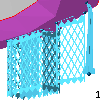

  • Netfabb comes with three default sets of manual defaults, each storing example variants for all support types, bar, volume, and polyline.
The three default sets of manual defaults come with variants for each support type.
