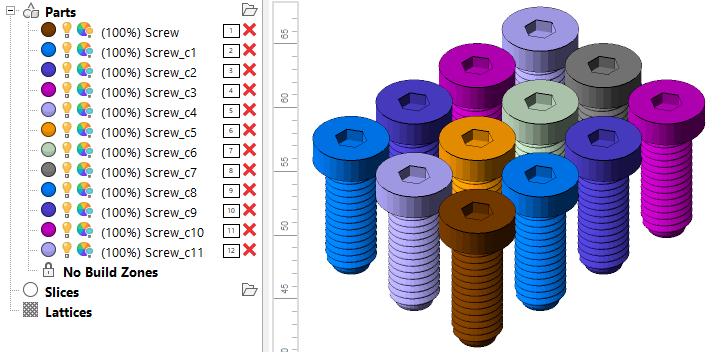

The display color is a color that Netfabb uses for the surface of a part or the contours and hatches of slice stacks. This information exists only within a project and is saved in a FABBPROJECT file.
Cases when a display color is used
- A part has no actual color or texture information itself.
- Actual color or texture information exists, but is switched off. (Global toggle: )
- A slice stack is being displayed.
Display colors represented in the project tree and in the display

Whenever a new or a replacement part or slice stack enters Netfabb, it gets assigned a color from a rotating color list.
Example cases that add parts or slices
- Adding a part to a platform
- Importing a CAD assembly as mesh and splitting it into distinct parts (optional)
- Repairing, duplicating, performing Boolean operation, manipulating mesh, cutting, generating a label, …
- Copying and pasting parts
- Moving a part to slicing
- Moving a slice stack to a part platform, generating a mesh from the slice information
In particular, the last two operations apply the same display color to the conversion results as the conversion sources had.
