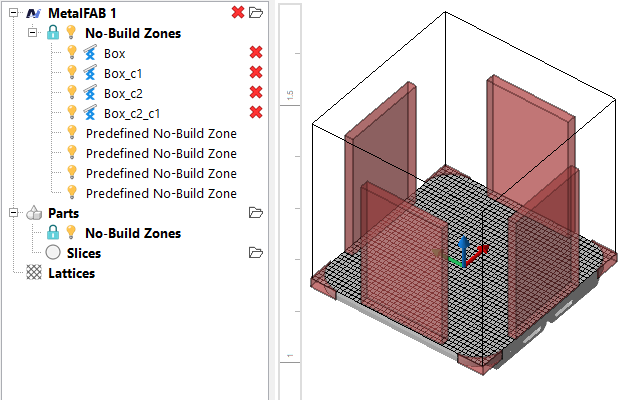

In this example, the zones at the corners are machine-specific, the zones along the sides are user-defined. All are listed in the project tree. The user-defined zones are also explicitly set to be observed by the support editor.
