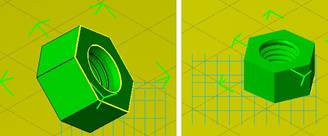

- To align parts with the X, Y or Z plane
- Choose the plane to which you want to align the part. In this example, the nut is leaning at an angle to the platform and we want to align them.
Action Effect
Aligns to the X axis
Aligns to the Y axis
Aligns to the Z axis - Set the distance between the two surfaces. For example, if you type 0.0mm the parts align, with a distance between them of 0.0mm.
- Click the face on the part that you want to align with the selected axis.
The single steps of the alignment are now listed in the tabsheet.
