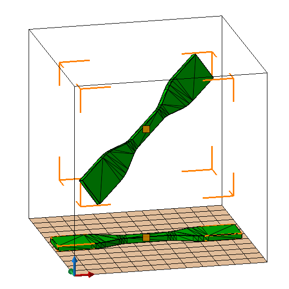

Let Netfabb determine a part orientation with the smallest space requirement in X, Y, and Z
Tip: If you just need to put the part on the platform, eliminating any distance from it that it currently has, use
Put part on platform instead.
- Click .
- Select the minimization strategy and choose an optional setting, if available.
- Click Start minimization.
The same part, before and after bounding box minimization and putting on the platform
Bounding box minimization reference
