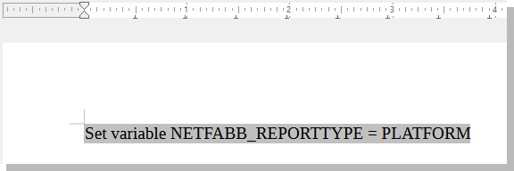

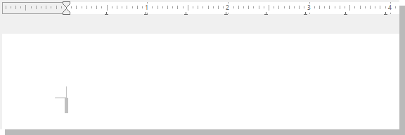

Tip: To help with placing and identifying fields, enable View > Field shadings. Additionally, you may enable View > Field names, but double-check that field definitions really were set up as invisible by turning Field names off again.
Display of field names disabled but field shadings enabled
Display of field names and field shadings enabled
