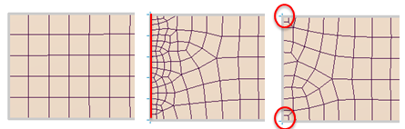

To refine the mesh locally, right-click on Mesh Model in the Model Tree, and select Add Mesh Control. You can apply mesh control for local mesh sizing on points, edges, and faces. You can control the mesh definition on edges either by specifying the number of elements or by the element size.
The mesh on the left has no local mesh control. The mesh in the middle has edge mesh control, and the mesh on the right has vertex mesh control:

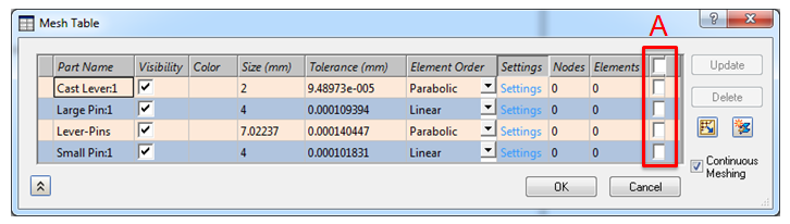

Mesh Table
To control the element size, order, and specify advanced settings for the each part in the assembly, use the Mesh Table. To open the table, either click the Mesh Table button on the Mesh Settings dialog, or click Mesh Table from the Mesh panel in the ribbon.
With the check boxes (marked as "A"), you can mesh individual or selected parts. This is a very useful tool for locating meshing issues in assemblies.

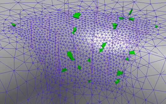

Reviewing Mesh Quality
To determine if there are sub-optimal elements in the areas of interest (where stress is a significant concern), use the Check Mesh Quality tool. Open this by right-clicking on the Mesh Model branch of the Model Tree, and clicking Check Quality for all Meshes.
This tool performs an analysis of the mesh, and identifies areas that may need further refinement:
